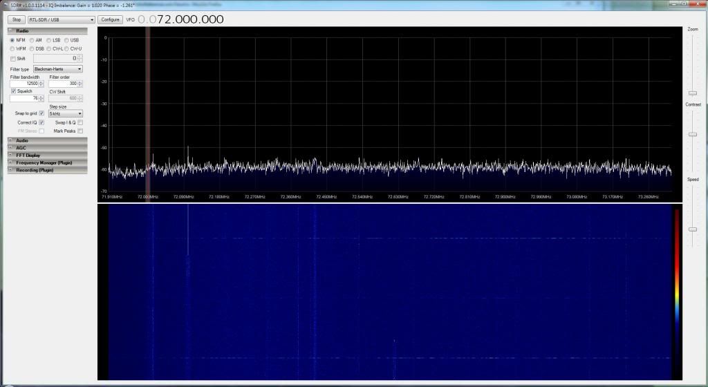

For casual listening you may find these useful.
The USB SDR dongles will cover that range.
(for around $15-$20 and free SDR# software)
You could use them with a laptop.
There's also an app in the early stages of development for using them on smart phones.
Rich
Some info here: SDR# | A Software Defined Radio in C#
And here: rtl-sdr
Versions available:
RTL2382U - The ADC and USB data pump. It is mated with one of the following three tuner chips.
E4000 - Tuner. 60MHz to 1700MHz
FC0012 - Tuner 50MHz to 1000MHz
FC0013 - Tuner 50MHz to 1700MHz
R820T - Tuner 24MHz to 1850MHz
One of mine tuned to 72 MHz.
You can see almost 2 MHz of spectrum at one time and tune to any frequency of interest.
