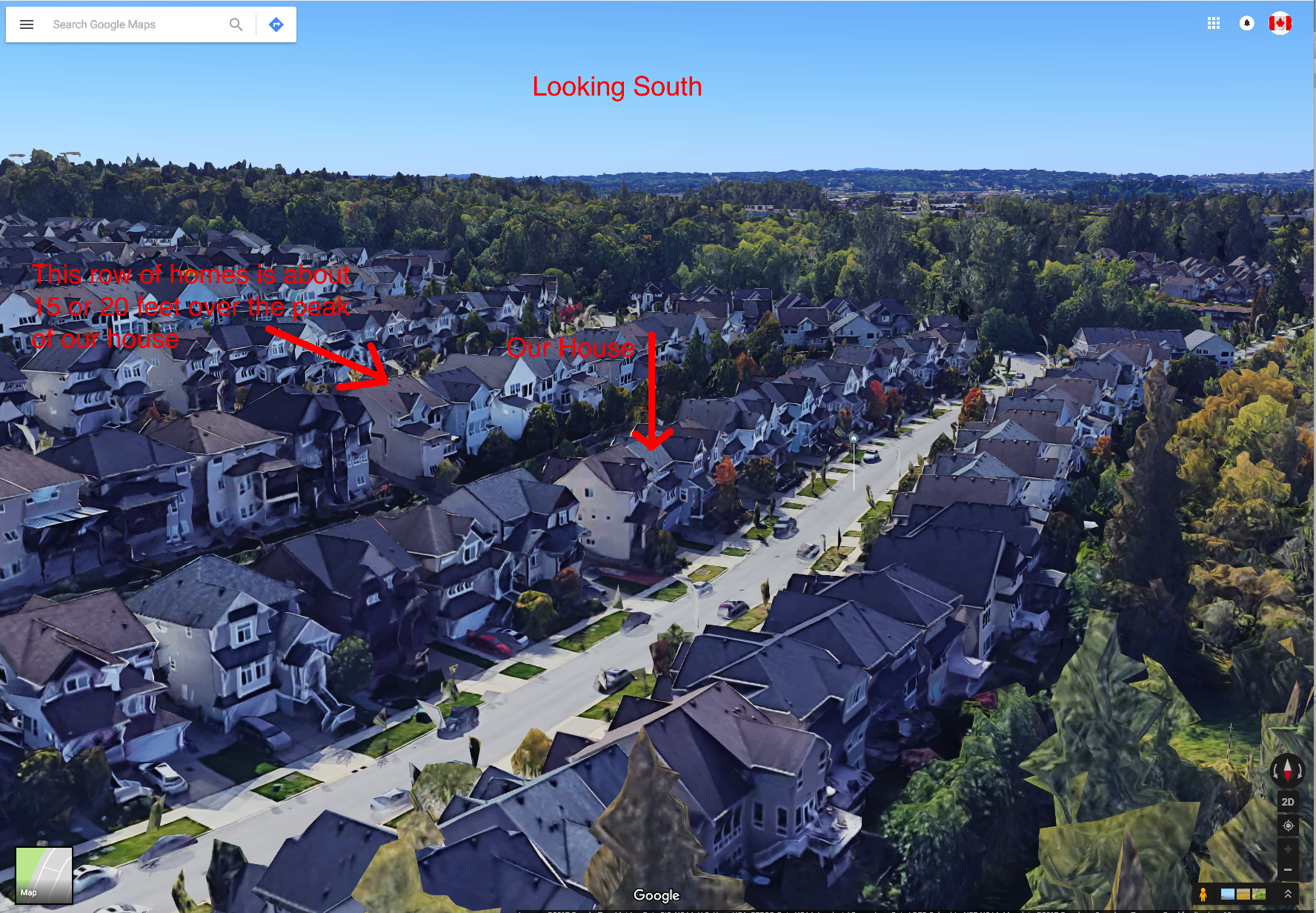

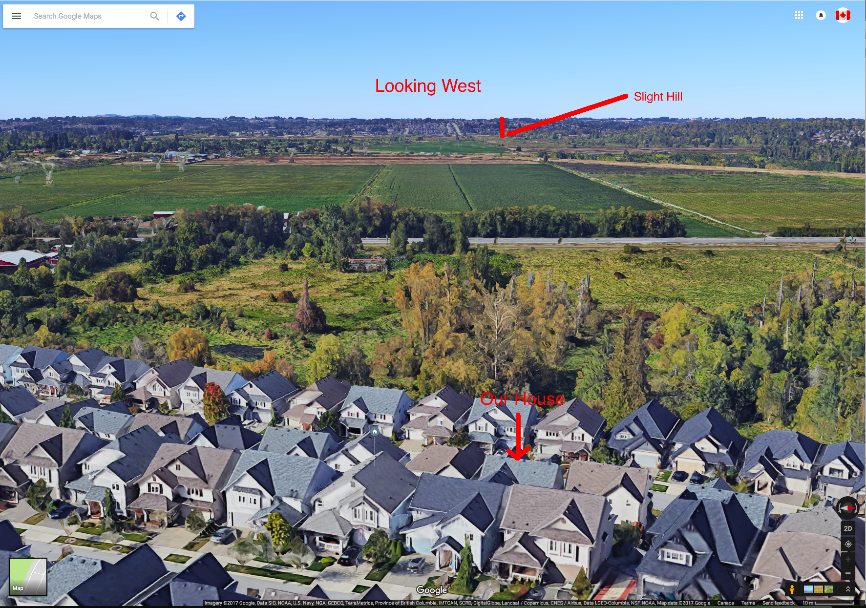

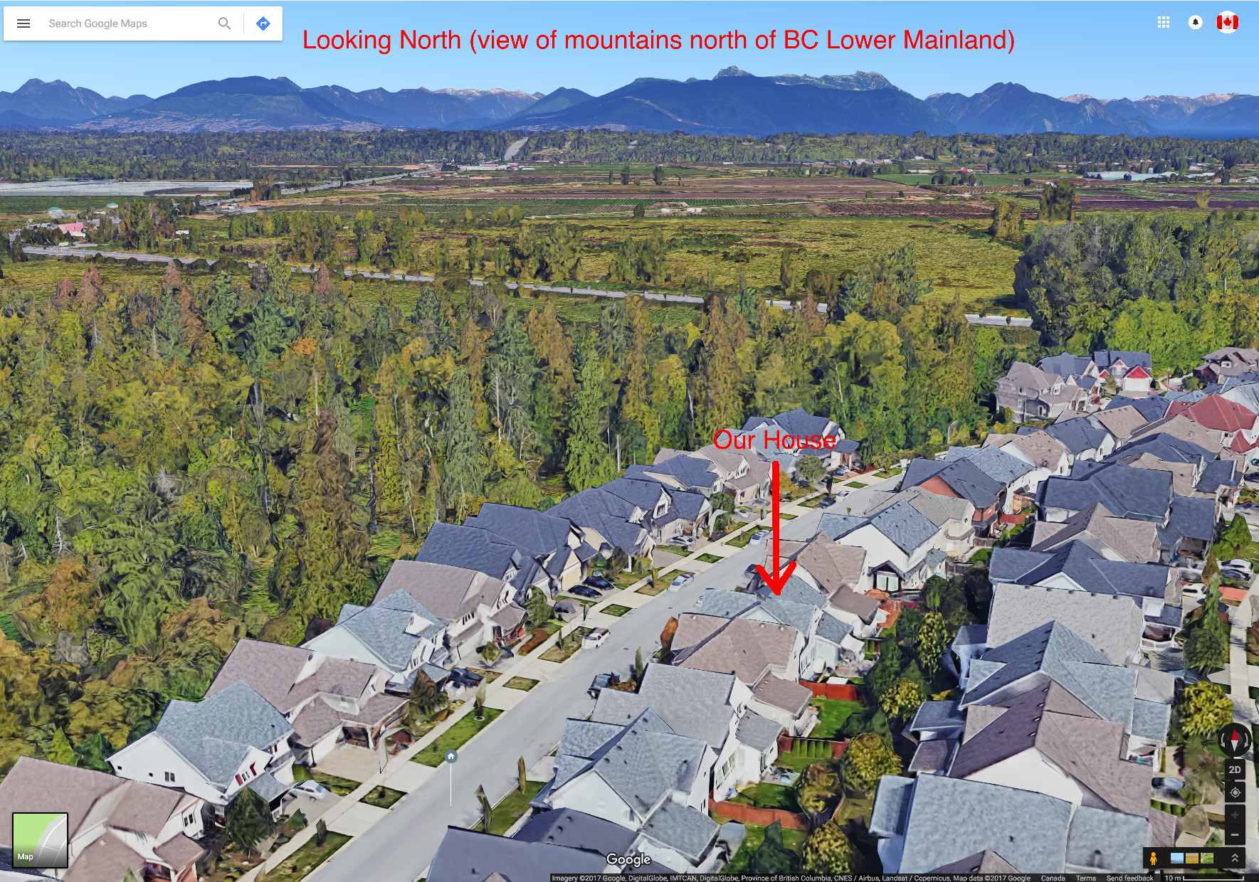

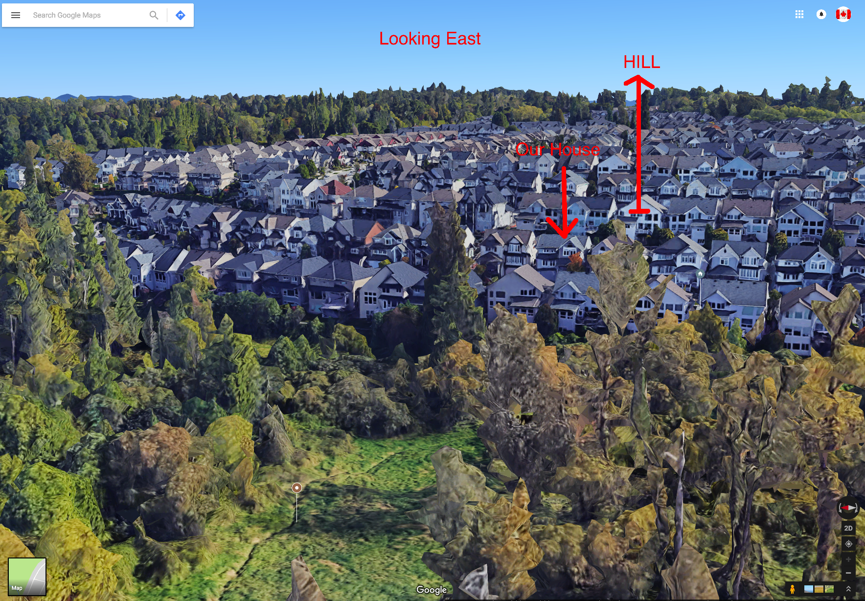

I'm trying to determine what the options may be for an amateur radio antenna and HF. Where we are located, there are hills that may interfere, and maybe to the point of it not making it feasible in certain directions.
Also the lots where we are located are not very big (4100 sq ft), so while we wish we had a big yard, or acreage, anyone in the BC lower mainland knows that means lots of $$$$$$ :)
Our worry is that because we're on the lower side of a hill to the east and also south east, it may cause some issues.
I'm wondering what some of the seasoned amateur radio hobbyists would do, if they were in our house and wanted to do HF (Dxing).
Here are some pictures we took off google maps to give an idea of the terrain.
Exposure North
Exposure South
Exposure West
Exposure East

Dipole, G5RV, etc would all work fine. No reason those mountains will interfere with anything. I've got friends and family that live up that way, although none of them are into radio, I have spent much time up there.
One of the government agencies had, or used to have, a large antenna farm south of Vancouver that was for HF. Seemed like it was geared for marine HF stuff.
You won't get huge antenna farm performance out of a small lot antenna setup, but there are a lot of amateurs running HF on smaller footprints than that. You'll need to be creative, but there's lot of help out there. There used to be an ARRL book calls "Low Profile Radio" many years back that had some good small lot solutions.
I used to work with a guy that had a single wide mobile home on a lot just big enough for the trailer and a car port. He had a full HF setup, vertical, loop, etc. and worked all over the world.
Of course he retired a year or so ago and moved up into the mountains on 20 acres and just put up a 100 foot tower, but he did just fine on the mobile home lot.

The roof peaks of the two and three rows of houses east ( Exposure East - Hill ) are probably 10 or 20 feet taller which could be near 45 degrees.
You can see the elevation differences a bit more in the south exposure picture ( Exposure South- Hill ).
I think we could go 10' or so max off the peak of the our roof, and anything more could have the homes behind me complaining. :(
The roof is T shaped with four peaks and about 36ft peak to peak.
If I understand dipoles. they'd need to be above "structures" as high as possible to get reflections off the ground?

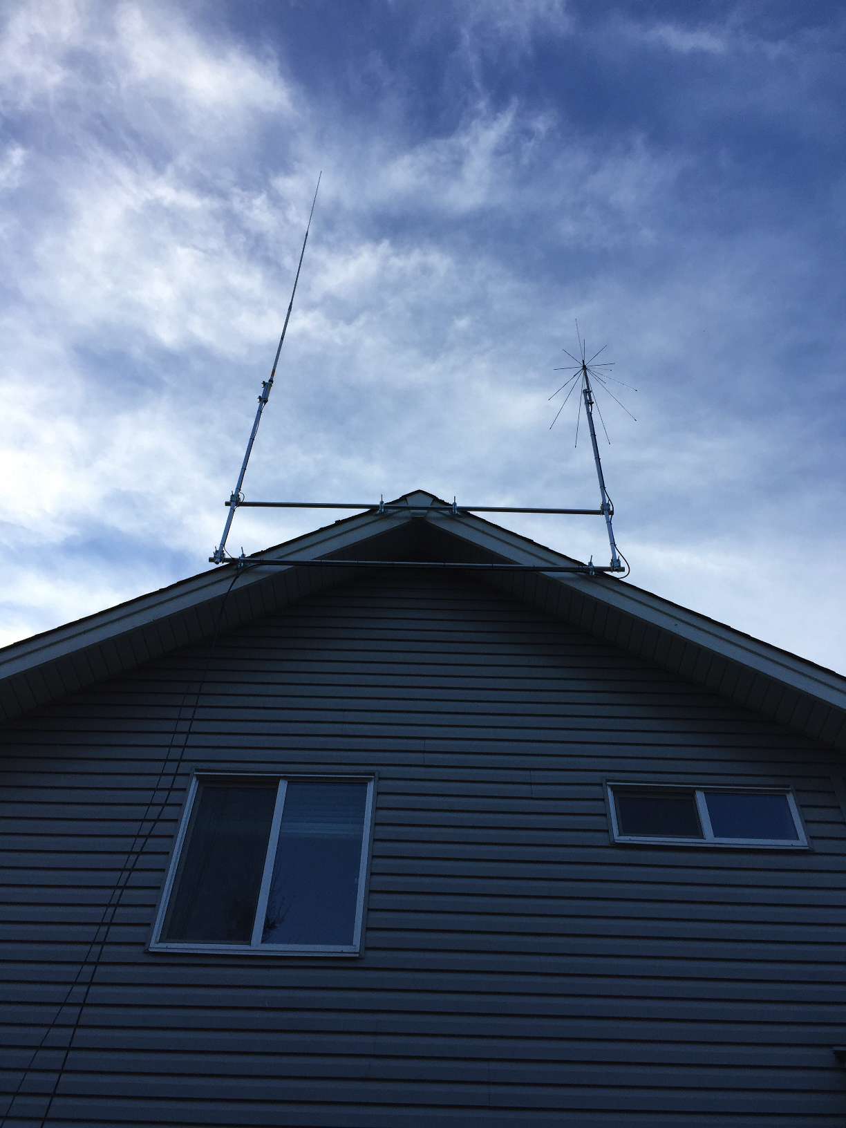

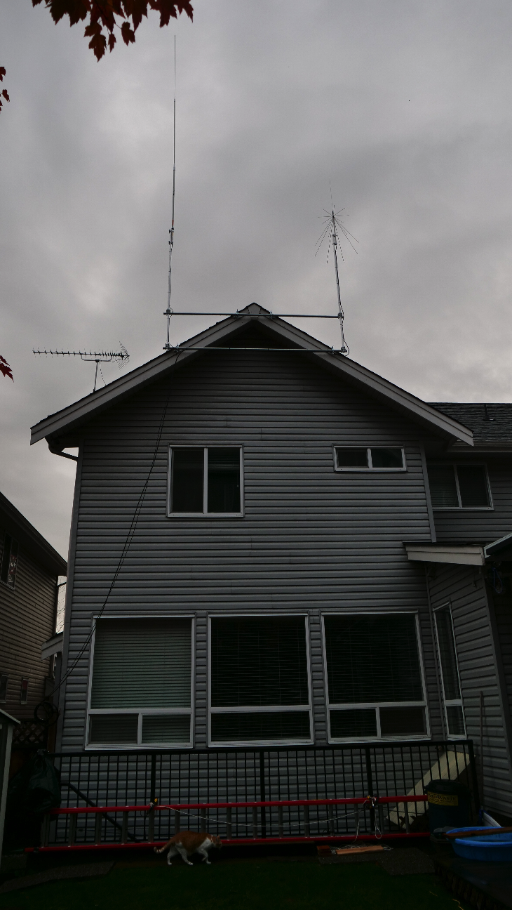

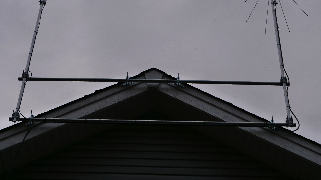

We put up a few masts/antenna's to test out the neighbourhood. We didn't want to go up too high yet or too far. No one has reacted so far.
Ant 1
Ant 2
Ant 3
We'll give it a month or so now before adding any thing else.
