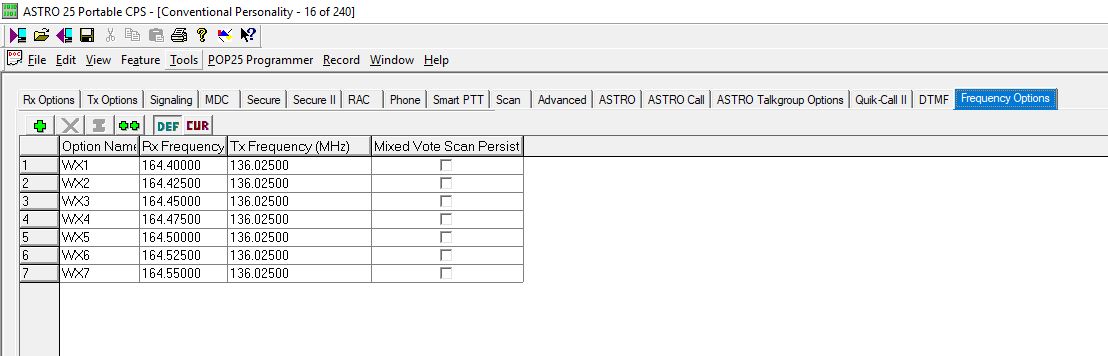

Astro25 (in later firmware versions, I do not recall the version at the moment) greatly enhanced the way we can use conventional vote scan by allowing us to create the voting list within the conventional personality rather than in a scan list. I'll use the receive only NOAA weather channel as an example:
In the conv personality, under "Scan", check the box for "Mixed Vote Scan Enable".
Next, under "Frequency Options", add all rx frequencies that you wish to vote.
You may also select the scan list type "Voting Scan", however that will vote the strongest out of every channel in the scan list regardless of the agency or user group. By using the method above, you may still use priority scan and vote the strongest channel within a personality (multicast systems), etc.
