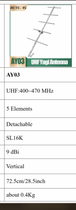

The metal siding will act like a reflector if you mount a vertical antenna 1/2 wavelength away from the side. On UHF, 1/2 wave is about 1 foot. You could fabricate a simple bracket with the NMO or other mount on it and it should work. If your hand held is having issues, you may see a ~slight~ improvement with a 1/4 wave antenna. A 1/2 wave or 5/8ths' wave antenna will give you some more gain.
If the signal is really weak, you can mount a Yagi out there and that should help quite a bit. Probably don't need a big one, just get a 3 or 4 element model. You can often find used Yagi's on eBay pretty cheap.
