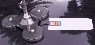

Am waking up in South Dakota getting ready down the edge of the Plains to Oklahoma. More food for thought:
RF Bonds on your vehicle a help seeing as how you’re apparently out on the road versus those puttering around inside the metro bubble.
Horizontal surfaces + doors + exhaust pipe as priority. (bed to frame & cab if pickup).
Diamond MAT-50 as another idea to try.
The past week or so with Skip reduced in intensity I’ve found it fairly easy to have near-silence with the radio turned almost wide-open during the day out in rural areas. (Lincoln II with ASC off and SQ at 02).
That would be easier to accomplish in a personal vehicle. A radio with NRC ought to be able to match this.
Then, with local comms, it’s uncannily like 2-way radio.
The local rock buckets are one thing, the cattle haulers are another. In Texas this would be on the major US Highways versus Interstate for best performance testing.
US-67 west of US-281 a very good road for that. Once you’re out towards Ballenger it’s Gods Country for CB all the way north to Canada. It’ll show up the low power, mag-mount and marginal signal capture you’ve got going.
Permanent antenna + KL-203 + RF Bonds + coax filter and you’ll talk & hear as well as the big radios despite using that tiny AT500.

Does the Diamond have rubber boots on the bottom to protect the paint?
