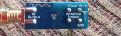

I'm new to Baluns, Im using it on vacation, where does the ground go off of the Balun?

Baluns are usually used to connect a BALanced antenna to an UNbalanced coax cable up at the top - the coax cable is normally used with the correct connector to the radio and is therefore properly joined to the ground..
