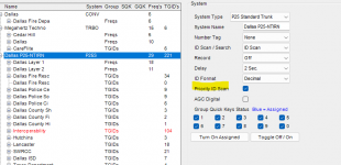

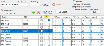

You may also want to set those analog channels to priority because if I remember correctly the P2 models will work great with analog systems being set to priority, but you actually cannot do this with P25 systems (and probably EDACS as well).
You can set trunked talkgroups to a priority status, but using the keypad to turn "priority" on or off does not affect trunked system talkgroups.
You need to enable talkgroup priority at the system level, for any TRS that you wish to use the feature.
FreeSCAN:
ProScan
Enable the feature for any TRS that you want to use it,
Then, within the groups, tag the desired talkgroups to use the Priority
Unlike conventional channel priority, trunked system TGID priority only works when the scanner is actually scanning that specific system, and checks the control channel to look for priority talkgroup activity when it is not stopped & receiving an active TGID on the system in question.
Once the scanner moves to the next active system, it will not go back and check the designated TGID until the next time that system is scanned. From what I've seen noted in the past, the chosen TGID also needs a setting in the system itself, for this to work as desired, but I don't, offhand' exactly recall what that setting entails.
