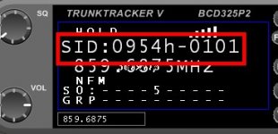

Try this to confirm you are receiving a Control Channel:
  1. Press HOLD
  2. Use the knob to scroll through the channels one by one
When you land on an active CC, you should see a SID pop up like this:
If you don't see a CC, you won't receive the system.
Good luck!
