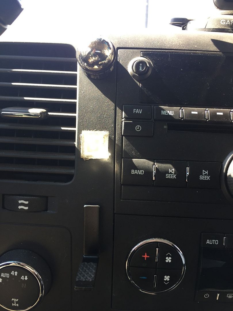

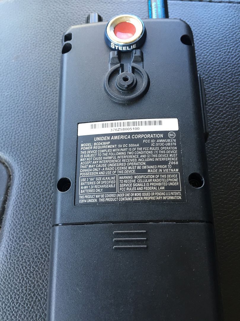

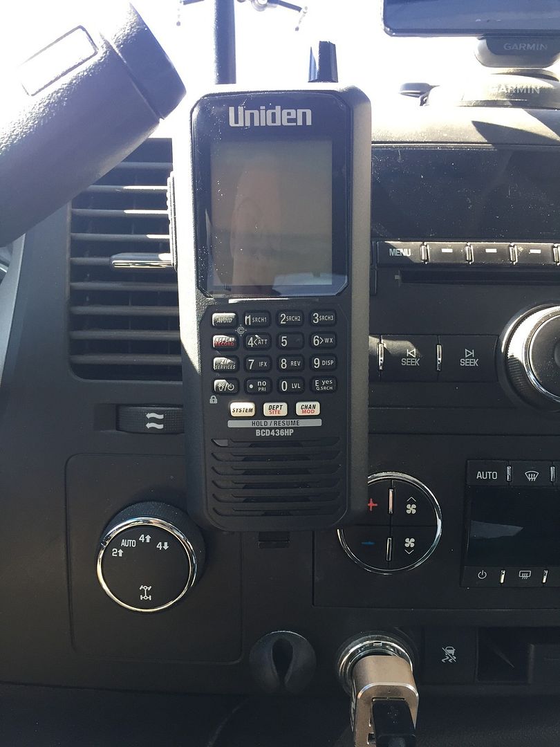

this one has a special adhesive that renews when put under the tap im in a freightliner
i have to literally pry it off
fyi i have no skin in the game it just holds my 436HP across the country solid across some of the worst roads
https://www.youtube.com/watch?v=KoSgxRAO2k0
