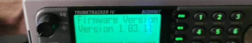

I am trying to update my brothers 996t. It currently has firmware version 1.03.11
I followed the instructions on the Uniden website for upgrading firmware. I tried using the downloaded BC_VUP program. After trying to run the .scn file it says because the current firmware is so old its concidered a major update, I need the scanner reg key....so I tried registering the scanner but it does not have the Esn checksum number listed under the esn. So I have to update to version 1.04.12 but the BC_VUP program still says I need a registration key to upgrade 🙄 I tried both BC_VUPv2.0.0.3 and BC_VUPv2.0.0.7.
I have to upgrade the firmware in order to register the scanner to upgrade the firmware 😭

It has been so many years that I am not 100% sure but I think the ESN part came about after the scanner was released. You may need to do this page install first:
Then you should be able to find the newly created ESN in the radio

You might want to take a look at this.
Ohh boy. So I may not be able to update the firmware at all. They even contacted Uniden & were told No updates can be applied to this discontinued scanner. I'll just update the database & if it dont work right I'll break the news he needs to upgrade his scanner too.

I went ahead and programmed scanner. Its working as scanning goes but the display does not show the clock, squelch or volume 🤔 I reset to his original program and it doesnt show then either. Any ideas?

That's odd, on my 996T, I get V=xx or S=xx in upper right corner as I turn those respective knobs. Firmware 3.02.00
I just checked mine again and those indicators are not there. I purchased mine in either 2007 or 2008 and it's still running with whatever firmware version it came with from the factory.

A bit more searching found a blog post by UPMAN with a how-to for updating the radio. As he was the Uniden tech whiz prior to his death, I would say this would be the best info found.. I think it is the same process described on the WIKI but in a slightly different presentation.
His post here stirred my memory of why the ESN was created, a prelude to those paid updates that were in the future.

I can't get a ESN checksum number.
