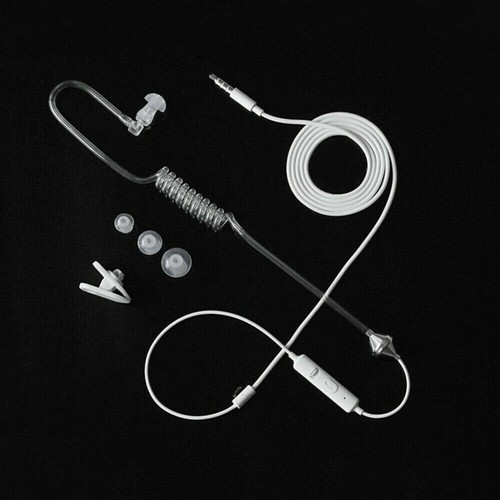

I'm looking for recommendations on a listen only ear piece. As a reference, what I'm talking about is this:
Previously, I bought one of these but the one I received, was defective, had to send it back and get a replacement. Apparently, the low price, did not ensure a first out of the box, satisfactorily experience. I'd like recommendations from current users.
I understand that, these things, due to the nature of their build, are prone to fail or performance issues, so, I'm looking for users who have had a high performance, trouble free use out of their chosen gear.
I intend to plug this into a Noxgear 39G bluetooth speaker so a 3.5mm connection is a must.
TIA.

Yes, I own a Noxgear. Reason I'm inquiring about...this solution, is because of the discreet factor.
I've previously owned one of these, not sure or remember what brand but, when I received it, the acoustic tube, was damaged, had to return it and get another one.
Seems this is a weak point in the design thus, my reason for looking for the very best quality brand out there, if there's one...

Yes!
The above device, being clear plastic, blends pretty much with the skin.
I can't imagine what else you have in mind that would serve my purpose, but, yeah, I'm intent on plugging the wired device into the Noxgear.
If I wanted another BT dangling from my ear, I have 3 BT earbuds with varying degrees of functionality with the G4.
Problem is, they're noise cancelling and although they do have an ambient noise mode, they tend to be VERY noticeable from a distance.

Lots of the single ear “surveillance” earphones have a mono plug that will short the left/right stereo jacks and result in low volume and (maybe?) damage to the audio source. A Bluetooth speaker with a 3.5mm headphone jack is almost certainly going to have a stereo pinout. I know there are “stereo to mono” adapters on Amazon but I’ve never used one and have seen mixed reviews.
I’ve bought a few of these ^ over the years for use with my SDS100 (which I believe has a stereo headphone jack). They’re cheap and direct from China. The quality won’t win any NAMM awards and it certainly isn’t good for high noise environments, but it is one of very few options I’ve seen that have a stereo (TRRS) plug feeding a single earphone. For $10 and free shipping I recommend you give it a shot.
