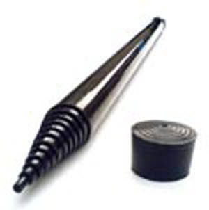

For setting it up heres my thoughts:
Pole: spider beam

25 feet of RG-8 cable on a 40 foot pole? Might work out fine if you don't put the pole up all the way. Actually, the last few top sections of those masts are pretty thin and won't support much in the way of an antenna. You'll likely need to guy the mast (good paracord might be sufficient), or it's going to flop all over the place in the wind.
