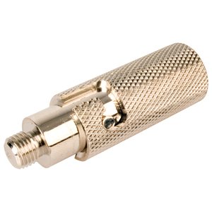

Something like this would be a much better solution:
https://www.gigaparts.com/diamond-antenna-k9000lrmo.html
