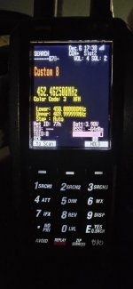

Did a custom scan and it stops on a frequency but I dont hear anything. Is this a setting?
C casemods Member Joined Nov 10, 2024 Messages 92 Reaction score 7 Yesterday at 9:19 PM #1 Did a custom scan and it stops on a frequency but I dont hear anything. Is this a setting? Attachments 20251206_173605.jpg 38.9 KB · Views: 11

R RMason Active Member Premium Subscriber Joined Sep 18, 2003 Messages 1,023 Reaction score 633 Location Mississippi / Colorado Yesterday at 10:24 PM #3 casemods said: Did a custom scan and it stops on a frequency but I dont hear anything. Is this a setting? Click to expand... I believe you have found a DMR control channel. A DMR system requires the frequencies and LCNs to be programmed in order to track the trunked system. You can try programming this system/site: Fisher Wireless TeamTalk Site: Toro Peak Fisher Wireless TeamTalk Site: Toro Peak Details www.radioreference.com

U Ubbe Member Joined Sep 8, 2006 Messages 10,573 Reaction score 4,354 Location Stockholm, Sweden Today at 3:49 AM #4 casemods said: Did a custom scan and it stops on a frequency but I dont hear anything. Is this a setting? Click to expand... Program that frequency in a OFT One Frequency Trunk system and you do not need to enter any LCN, or Color Code, to be able to hear all conversations from that frequency. Set it to IDSearch and program one talk group in its department. /Ubbe
