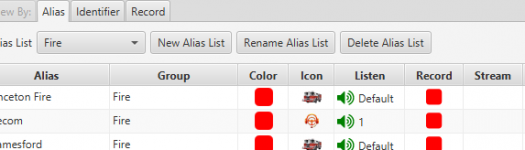

I'm not sure what version you are using but on version 0.6.1 there is a delete alias list. If for some reason you need an older version maybe download the new one unzip run it delete the list exit run on other version
Thanks Dave. I am indeed running 0.6.1 on Linux Mint which does not have a rename or delete option. Again, not a big deal, but I would sure like to clean out some empty alias lists.
