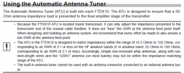

Most internal tuners in modern radios can handle an SWR of up to 3:1 which would be an antenna impedance of 16.7 ohms to 150 ohms. If your antenna's impedance is between those values, the internal tuner should handle it.
From the owner's manual:
