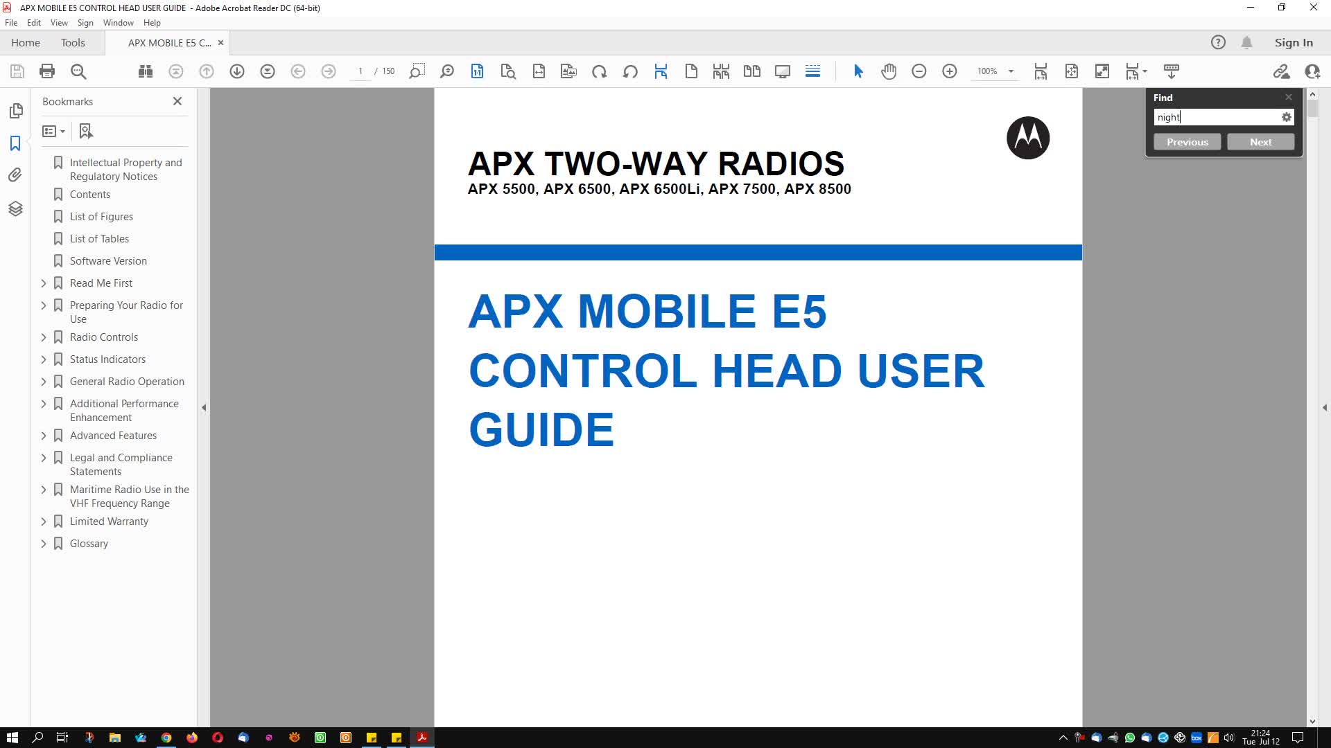

Google search "Motorola E5 head" and download the user manual. The answer to this question and more will be contained therein.
I did scan through it and saw no mention but I did take your advice and download to read up on it tonight.

The O3 does support it, it's an assignable function. The manual as of March 2022 says it's supported.
What the manual says and what the radio does are two different things...
Interesting...I have a 8500 with an O3 HHCH and using the softkey it will go bright, dim, no light on short press and long press does nothing.
Same here, several O3s were tested on several APX radios all at FW 27.02. Holding the button does nothing.
I was wrong, two different Motorola manuals contradict each other. The user guide makes no mention of day/night mode and the manual I posted earlier does. F...... Y.... Motorola.

They probably blindly copied/pasted stuff from a different manual into the O3 manual. You'll find the same in the APX service manuals...lots of contradictory and outdated info, even in the most recent revisions.
It's worth noting that the O3 head is nothing more than a 6000/8000 display module inside a handheld mic. It's likely that there is no night mode capability for them, unlike the mobile displays. The closest thing you'd get is the night vision mode that the SRX 2200 and APX 8000 with SRX package are capable of.
