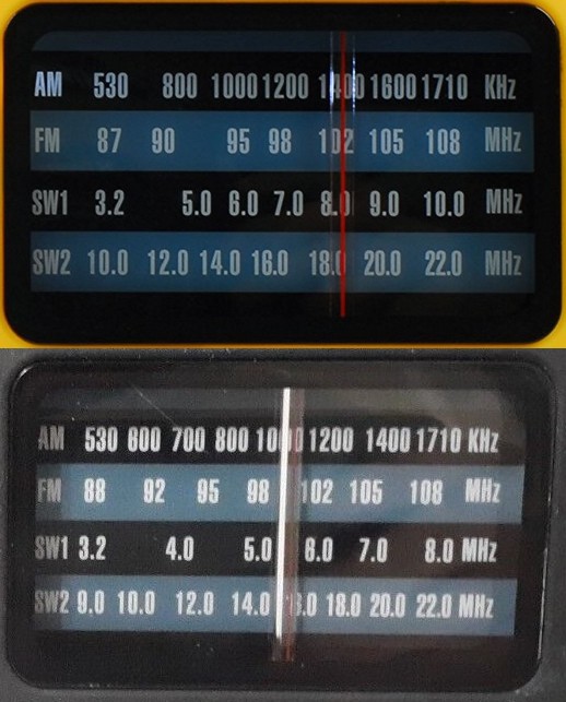

wenzeslaus
Aug 30, 2023
147
AFAIK the KA-500's are all digital. would be interested in an analog one.
a lot of times you can tell a DSP because the AM freqs are linear, don't look like a log scale and get all bunched up on the end of the band, and FM goes down to 76 (or ?) FM because it has to, the microchip is encoded that way.
so, if the old ones are analog, that might be a giveaway.
I looked at the manual, it didn't say anything about stepping. I'm sure no reviews mention that. I discovered it when tuning on the one I had, it sounded funny, so I counted the steps between 2 freqs on the analog dial, came out to 25 kHz. didn't bother to check what they were on AM and FM before I sold it.
if anyone has one, you can check it. all you have to do is listen and count how many steps between 2 frequencies.
wenzeslaus
Aug 30, 2023
147
aha! some used ones have 600 and 700 on AM and don't have 1600 because the rest of the numbers are scrunched up to the right. FM starts at a normal 88. SW does 3.2-8.0 and 9.0-22 instead of 3.2-10 and 10-22.
maybe those are analog.
