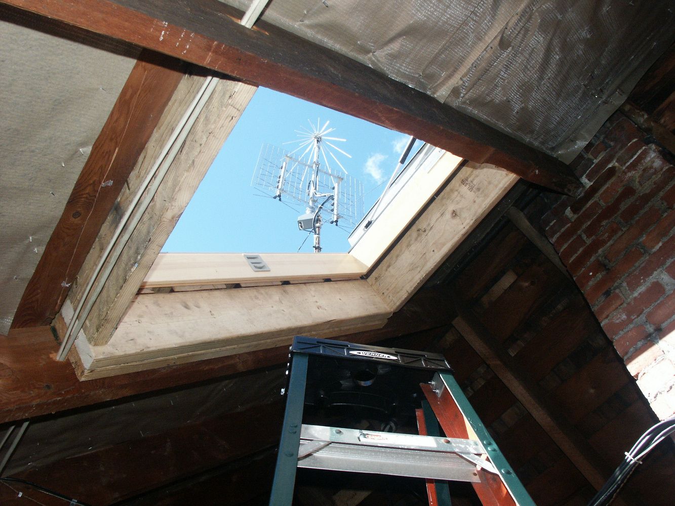

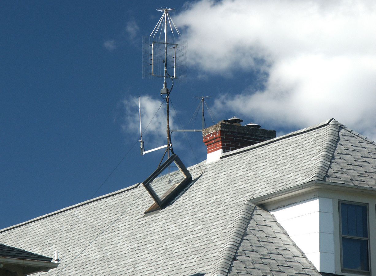

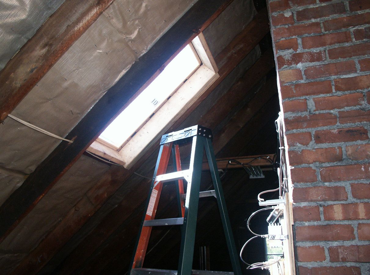

I choose the smallest window. It fit between the rafters, so no rafter cutting was necessary. I had it placed as high up as possible. I have a 8' fiberglass folding ladder in the attic, so that aspect was covered. What I needed was w short ladder fom the window to the peak. I can climb out and get to the peak without, but that isn't the safest idea.

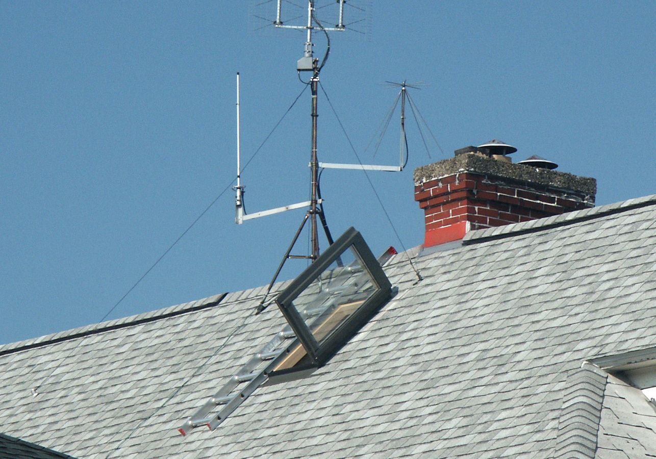

I looked around for a 16' aluminum extension ladder since I already did the same thing with a 32'. Splitting the two half's, using one for the "roof ladder" with a "chicken hook" (I believe that is what it is called) to hook around the opposite slope of the roof for access from the gutter.
I did the same for this 16 footer, but bought two pair of 8" 'L' brackets with a 2x4 placed between them for the 'hook'. One of those 'chicken hooks' is too large and heavy for such a short ladder.
It works out fine. I had enough room between the frame of the window and the closest leg of the tripod (I didn't want to move it) and the 8' length was just about right. I can lift it up and out, then return the ladder back inside the attic in a minute.
Pictures below:
