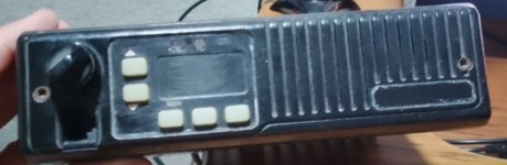

I have a radio that when turned on it makes a long beep and according to the chassis serial number D33MJA73A5CK (Maxtrac 300 16ch) but the radio doctor when reading it says M33GMC29C2__ (M120 16ch unserialized) it connects, reads it but does not let you write anything and gives an error "check error" "external CP write error" I can also connect with the software (DosBox) Maxtrac M12, GM300 but I still can't write any codeplug and it says "Error Number 2 Has Occurred: Serial Bus Error Make sureradio is turned on. Check RIB power cables & connections" I'm not sure I have the correct file. Any ideas? Thanks

The pictures you posted are of a Maxtrac, not GM300. It sounds like someone has forced a GM300 codeplug into that radio. I forget the correct RSS for the GM300 but there is a homebrew software package that will run under windows, if you search for it it will pop up.
First thing you need to do is get an older 1995 to 2000 era computer with a real RS232 port and a DOS OS, no USB to Serial, and defiantly no DOSBox, that is just asking for more problems. Even if someone forced a codeplug in you may be ale to restore it to a Maxtrac with the correct level of RSS assuming there is not any hardware related issues (that is at least a 25 year old radio)

Hello, thanks for the explanation. All my clues point in that direction. I think I can find a not-so-old PC with a serial port. I'm going to look for the right rib, but I still have doubts or problems about which codeplug to use.

If you are able to read it and write back I would leave it as is.
By the way the home brew software is called GM300 Radio Doctor, it is or was free.
