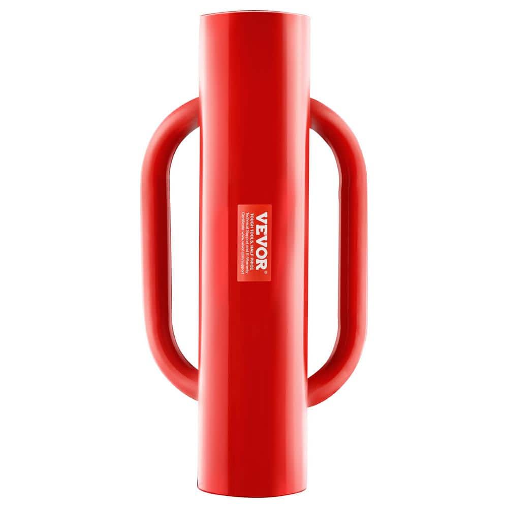

Guess I'll buy a demolition hammer kit and a ground rod driving attachment to go along with all the ground rods I'll need. Swinging a sledgehammer is not something this old guy is up to anymore.
Those are great tools if you are an electrician.
For running in a few rods, you can save some money and just use one of these:
I used one of those for years. You still need to smack in the last foot or so, but that's usually pretty easy once the rod in well into the ground.

I used a fence post driver for most of my ground rods. It is a heavy steel pipe with handles. Ear plugs required.
