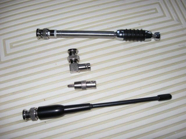

I have 2 antennas from Radio Shack but no correct adapter. I have the 90 bend but I need a screw in to HP adapter. Anyone know what its called? See pic of what I have.
Ron
