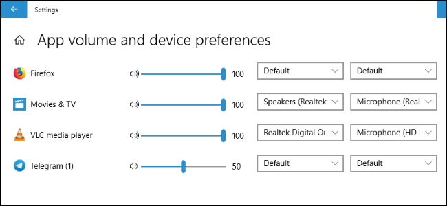

Works for me:
Now you may ask yourself. "Self, why don't I see my app in the list?"
Launch the app the take a look. It will be there.
Yep,,there they are big as life and also greyd out with no ability to select them. 'Now what'.
