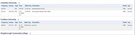

If I see something like this in the DB should these DMR frequencies be programmed into the scanner individually as OFT systems?
Screenshot 2025-05-30 at 11-13-36 New York City County New York (NY) Scanner Frequencies and R...png
Or could they just be included in a conventional department listing along with other analog and/or digital frequencies? In which case you could only enter the color code. Would that suffice?
Are they essentially single conventional frequencies that happen to have a DMR voice? Or is it more complicated than that?

A DMR frequency has 2 audio channels (Slots) available. If you see talkgroups and slots listed, program it as one frequency trunk. If more than one talkgroup is listed for that frequency, program both talkgroups into the same one frequency trunk system. You can then name each talkgroup. The color code goes into the site.

It all depends how a radio is programmed. In some cases, two talkgroups could have the same TGID and the channel is selected by the slot. In that case, you would program 2 talkgroups with the same TGID with one programmed for slot 1 and the other programmed for slot 2.
