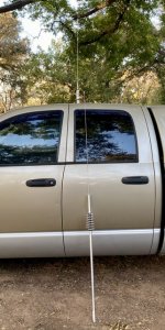

From experience I wanted no compromise re antenna with a 62’ combination (big truck is 72’).
(7’ PRESIDENT Texas 1800 on a BREEDLOVE #601)
Stationary, this clears the TT roof by 3.5’
The rest of the install as I get to it.

Antenna Choice
I knew I wanted 7’ as the 9’ quarter-wave both too tall and whips around at speed.
Breedlove #601
I purchased it with optional larger backing plate (plus foldover).

Antenna Mount Install
After pilot holes used a GREENLEE Radio Chassis Punch (5/8; #730).
Had a neighbor hold a wrench over roof as I tightened from underneath.
Even with my long arms this was quite a reach to prep and install.
It replaced the WORKMAN Starpad Launcher triple mag I’ve had almost thirty years. Have rebuilt it several times. Have had many antennas on it.
It’ll be around indefinitely. I’ll use @prcguy capacitance increase method. Have supplies, just haven’t yet soldered woven braid to copper sheet/refrigerator magnet sheet combo.
I “know” that roof center is the desirable location for an antenna.

Coax
Will be an extra-short run.
Currently RG316
As both big truck and the pickup need feedpoint choke (the previous solution either hard-to-mount or too bulky):
That project stalled at present.
The coax will likely get changed around several times (several pieces).
This’ll get used in pickup on cab side of headliner; for now.
Decided to crack apart the big truck rig to use this in the pickup.
