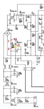

Is it normal if there is an AC input voltage between positions 1 and 2 ?
There should be a resistor R2 there, which is completely destroyed every time the switch is turned on.
I tried turning on the device without R2, there was an input AC voltage of 235V. Suddenly I attached the multimeter measuring cables to measure the voltage of Q1, that is, TM1641S-L between T1 and G, so the device turns on, and at that moment there is no voltage between position 1 and 2, that is, where R2 6.8 Ohm should be connected.
I removed from the board Q1 TM1641S-L again and measured the contact resistance with a multimeter, and the contact is just about zero between T1 and G in both directions, between the other contacts in any direction the contact resistance is infinite.
Triac TM1641S-L when everything is connected on the board, including R2
I measured these values with the device turned off:
between T1 and G 36 Ohms
between T1 and T2 7 Ohms
The only thing I'm not sure about is the value of D9 when the HZ4A2 Zener diode was removed from the board. It had a transition of 0.7 but in the opposite direction it was 2.8. Is this okay?

First, if R2 is blowing with no load, you have a short in the filter chain, possibly LF 1, 2, or 3.
C4 or C5 can short also, they have to filter the high frequency and big electrolytics don't play well there.
Q1(triac) is part of the current sense, feeds back to the converter transformer. So, if R2 blows, the converter shuts down.
