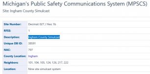

The 996p2 comes w/ P25, but. Is not Simulcast-capable
There is only one P25 system listed in your county: Michigan's Public Safety Communications System (MPSCS)
The one tower in your county, on that system is Simulcast.
In the neighboring counties, of:
Clinton-Simulcast
Eaton-Simulcast, (non)Simulcast
Jackson-Simulcast
Livingston-(non)Simulcast
Washtenaw-Simulcast
so, You could try the (non)Simulcast towers in Eaton n' Livingston counties
Also, Disable weather alerts and Close Call
