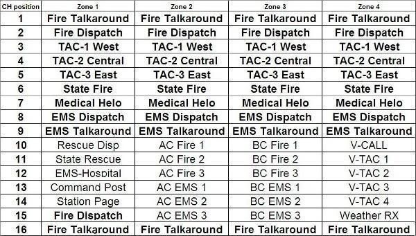

Maybe 16 channels is really enough for the average public safety volunteer. Anyone have experience with this?
Towards the end of my volunteer days (97-99) my dept had some Kenwood TK-270s that only had 16 of the 32 channels programmed. I got permission to have the rest filled up since I worked in another county so I had quite a few RX and a couple TX channels added. So back then 16ch was enough for what we did, but now with so many extra channels some areas have I could see a 16ch radio being a limitation.
Say you used six channels in your everyday needs, I could see a radio with multiple zones having those six channels being the first six channels in every zone so you would always have immediate access to them. Then the other zones could have whatever extra things you need/want.
OK, I was bored, I made a quick template with two other counties listed as "AC" and "BC". I also listed "Fire Talkaround" as the 1st and last channel so it would be easy to find without looking, just turn it all the way in either direction (works well for radios with a channel stop, not so well for continuous rotation knob equipped radios).
This was based on my last county of residence and a general listing of some of what their radios had (just moved around a bit with some fictional things added) so most of your radios would not have a medical helicopter frequency but they talk direct to Med Center Air on their VHF frequency instead of having the helo go to a tac channel.
