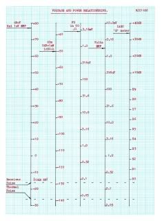

The trouble with dB's is that they need a reference point. Without that, they are just a ratio. Some radio's express a sensitivity with reference to "0dBm" where "0dBm" is 1milliwatt on 50 ohms. If you do quite a bit of complicated arithmetic, this works out to show that 1microvolt in 50ohms is -107dBm.
Others go the other way round and take 1uV in 50Ohms as the reference point, so everything is a positive value.
Some time a go I drew up a chart to show all the relative values....
If you want a better version then PM me.
