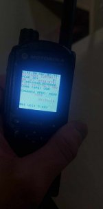

when saving the radio, I received a connection error -16% error connect write - the radio has an empty flash
Can I re-upload flash?
i don't have flash bin :(
the radio does not respond to anything - there is a signal connected to the PC via cable
specyfication radio:
FW: MR5.14.10f410691155_745947647439220_5586751893697548201_n.jpg
