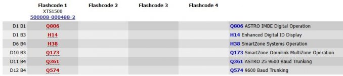

H79KDC9PW5AN
This is what it decodes to with no compatibility errors.
Decoded by the akardam.net Flashcode Decoder v5
Platform: PM1500
Flashcode: 100001-000000-7
G806: ASTRO IMBE Digital Operation
G48: Conventional Systems Operation
Moto has been known to make custom Flashkeys, for a price, that would change the electronic model # and/or flashcode. They did it for NEXTEL RB radios to make them P25 and 700 MHz capable outside of the original RB agreement. That could have been done here if the codeplug hasn't been tramp stamped.
chrismol1
P25 Trucking!
Mar 15, 2008
1,365
There appears to be two factory packages for the PR1500 VHF that show Feature Set
MT/PR Analog Cvn Data 000001-002000-5 Q833 MDC1200 Analog Conventional
P25 MDC Conv Data 100001-000000-7 Q811 P25 Digital Conventional
The online decoder showing different can happen, I see what you said. For instance I have a factory XTS1500 that CPS feature set shows only Q574 9600 Baud Trunking, ADP but will decode the full individual features on the online decoders. As the Q574 internally in CPS includes all the others. If I was to try to encode it as it shows in CPS as just Q574, it will also show different. Some things to be aware of on those type radios as they were built/show a little different than the other higher end models. It can also be a giveaway to altered radios vs factory when you see stuff like that.
