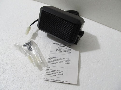

Has anyone used a speaker other than Motorola? I was wanting a speaker a little smaller to use with the XTL5000…..
Motorola got smaller speakers and I've tried different models. That HSN4042 type use a thin plastic casing and it isn't good sounding too me. The best smaller speaker from M with a similar size as HSN4042 are probably the SSN4005A type that use a much thicker and heavier wooden type of casing and the speaker element seems also to be different and have a really pleasant sound. Maybe it is rated for higher wattage as well. The model number will change depending of what connector that sits at the end of the cable. I believe it was too expensive to manufacture and probably too good for its purpose so are only available as vintage and second hand.
