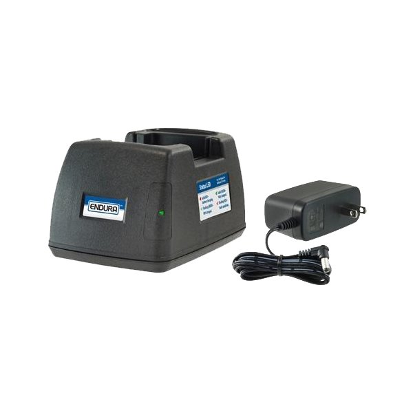

Hello. I just got this new 4300 mAh XTS 3000 battery and the charger I have is model #: AA16740.
I put it in charge and for a little bit now both the Red (Charging) & Green (Complete) lights are blinking at the same time, I never seen my charger do this before. So just wondering what this means. Does it mean I don’t have the right charger for the battery or what.
i have attached a picture of my new battery & the charger I have
Let me know
Thanks

What is your battery chemistry? If it is a Lithium battery, you have the wrong charger. I believe your charger is for the NiCad and NiMH battery chemistries and not Lithium.

Ok and I posted a picture of the battery I just received. And it is a Lithium battery.
so I will need to get a Impress charger for it

You don't need an Impress Charger if you're not resetting an Impress battery each month. A non-Impress charger that will accommodate a Lithium battery charging cycle will do.
Although, you can also use an Impress Charger with a non-Impress Lithium battery.
If I were you, get an Impress Charger and battery if you want the battery to last 10 or more years.
