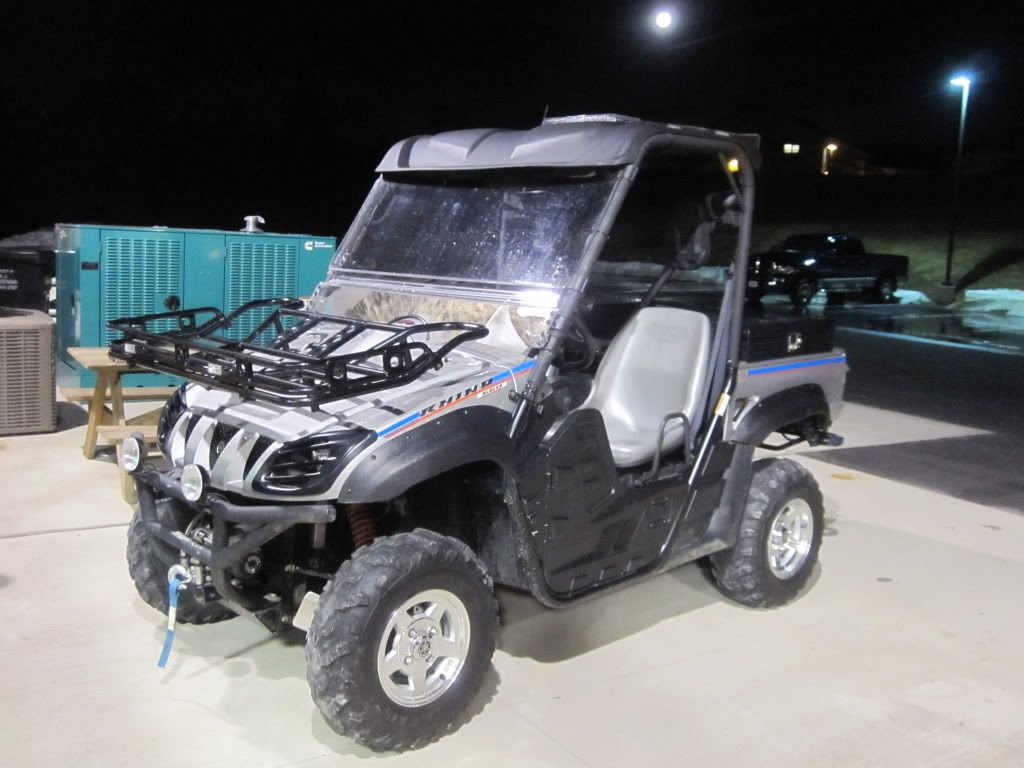

on the FD's the antenna is mounted on the back passenger side of the roll bar, you can barley see it sticking up in the middle of the pic.
