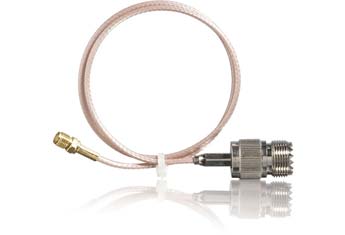

I want the option of connecting one of our hand held radios to the base station antenna on occasion. It takes a female SMA connection. Can I just use a short jumper with the appropriate ends? Will the thinner, more flexible wire on the jumper degrade my transmit and receiving capabilities significantly?
http://shtfinfo.com/images/sma female to s0239.jpg

a short jumper is fine, and is the recommended method of connection since the LMR is not real flexible.
