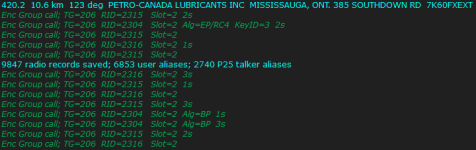

I stumbled across this booming signal this morning while trying to log the Suncor Plant on Southdown. I thought this may in fact be Great Canadian Casino but their colour codes don't seem to match what is in the database. I suspect that either this is the Casino that has switched to a tier 3 system or Potentially Suncor out here in Mississauga. I am currently pulling this in from Port Credit so I do suspect the Suncor/Petro Canada Plant. All appears to be using EP/RC4 with a KID of 3.
Any information at the bottom of DSDPlus to identify TIIISTd/NonSTD/Moto? Looks like the voice is on slot 2. So either that's the second timeslot on the CC, or you're listening to a voice channel. Or it's not a T3 system but conventional DMR. I have a feeling your monitoring a voice channel since there is no LSN mentioned.
