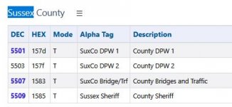

These are the only TGs from Sussex Co where Lake Hopatcong is located, others maybe in use but not identified yet or encrypted.

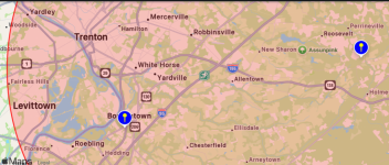

Using a trx1. I monitor NJICS everyday from the Bordentown simulcast site that is directly across from me. I am on the Pennsylvania side right on the river.
I just monitor C3- 10 which is the NJSP Marine Division and C3- 01 division call which is the NJSP Aviation. Occasionally I listen to C3- 02 that is Trenton police dispatch in the clear.
I personally have never been able to get the trx-1 to work on any phase ll simulcast, it also does not work on Bucks County or Burlington County for me.
Maybe it works for others but I've never heard about it. Works fine on SDS series.

Using a trx1. I monitor NJICS everyday from the Bordentown site that is directly across from me. I am on the Pennsylvania side right on the river.
That's because you're only within range of the Bordentown Simulcast site physically in Bordentown. The other (3?) sites aren't a factor for LSM distortion to be an issue on a TRX-1
I don't follow John, right next to the Bordentown site we have the Trenton simulcast site which I could also use if I wanted and when I'm in Trenton that's what I would use. I only listen to one site at a time.
I have tried using it in other locations on NJICS using the closest simulcast site to my location and no go. That goes for the Cape May simulcast site also when I am in the Villas.
Unfortunately my own County as you know has been using Phase ll simulcast for over 10 years, it has never worked on a trx1 for anyone I know.
Can't believe we're debating this age old well known fact 🤣.
Hey if somebody can get it to work using the voodoo that they do do more power to them. As you, of course know, it's location location location. I just never found that location on a trx1.
I don't have a dog in this fight. Trx1 is a neat little radio, still love my PSR 800 as long as I don't need to hear phase ll simulcast.😉
Right but keep in mind that each simulcast cell is composed of several individual sites which all transmit the same transmissions on the same frequency at the same time. I'm saying you may only be within range of one site on the Bordentown Simulcast. When you visit Trenton, you may only be within range of one site on the Trenton Simulcast, so simulcast distortion may not be an issue if you can hear all transmissions clearly on your TRX

The RR database has talkgroups in the library (DEC - 4 digit talkgroups) and I have selected and loaded them using EZscan. I always thought these talkgroups were 5 digits such as 35952, 35120 and 36784 but I see no 5 didit groups in the library...
Of course each simulcast site consist of sub sites that transmit simultaneously.
That's why the 100 and the 200 that have SDR chips in them receive NJICS flawlessly. By the way they would only work as well as they do because I have a Larson triband on my car and a rooftop antenna on the house so there is no breaking up of signal not receiving the furthest sub site from a simulcast site with the 100 and 200.
From home I could really use either the Trenton simulcast site or the Bordentown simulcast site, the Trenton site is just North of the Bordentown site, likewise when I'm in Trenton I could use the Bordentown simulcast site successfully.
The TRX 1 is P2 capable and not all phase ll is simulcast. The TRX difficulties with phase ll simulcast is a well-known fact.
Occasionally when I am in lower Township, the Cape May simulcast site also works flawlessly on the 100 and 200 but does not work on the trx1.
You know me long enough to know that I do know a little something about this stuff.😆😆😆..
If it makes anybody feel better, the 436 and the 536 doesn't work so great on Phase ll simulcast either, better than a trx1 but not great.
As far as North Jersey goes I'll be the first one to tell you that I never go up there, wouldn't even go close to New York City for anything so what happens up there I don't know, I'm not familiar. Central and South Jersey, I know.
Just a miscommunication here, again I think you know my experience as I do yours.🙂
