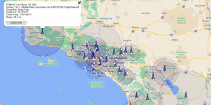

No county shows all the sites. Any thoughts on why
Correct. Each site covers a certain area so LA County won't show the Santa Ynez site. See the map below.
I thought that also - but that isn't the case. Imperial County shows the same 18 sites that LA county shows... none of which are close to Imperial County ;)
