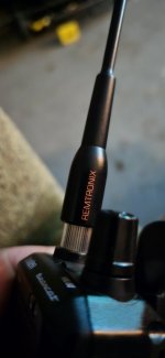

I just got an sds100 and I feel like I was getting way more traffic on the 436hp. Basically I just had all county stuff as a fav list and turned a few on when I'm in the area.
Same antenna. Not sure if I'm doing something wrong or what. Same exact antenna too... remtronix something
