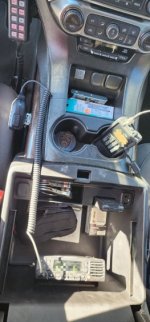

Looking for opinions.
Radio shop installed a mobile in my Tahoe, right in the exact spot (of course) I was placing my scanners (Usually a TRX-1). If I lay it in proximity to the mobile, what do y'all think about chances of blowing out the RF amp in the scanner? I don't like leaving the scanner out from cover for sun exposure, even though the windows are about 15% tint.
FWIW the antenna for the mobile is a little 7/800 pepper shaker hidden in the rear quarter panel.
