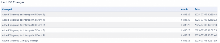

They were just added to the database today.
You have to wait until Monday for Sentinel to do it.. Or get @ProScan which will pull it in instantly.

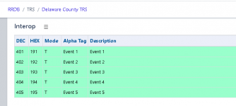

In the RRDB the interop group is shaded is that an issue that causes Sentinel not to download ir
Can you post a screen shot? Sentinel should not be seeing something that was added today. Sentinel connects to Radio Reference servers on Mondays.
Got it have to wate
When you say shaded, you mean Green? Anything that shows green means it was updated within the lst 24 hours.
With Sentinel, you have to wait for the following Monday and have to update the full database in Sentinel for it to be available in the scanner.
With @ProScan, the minute something is updated in the db, it can be put into the scanner instantly. And if using RRDB Differences feature,
Pretty much a few clicks and its in the scanner..
