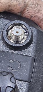

When troubleshooting a signal issue, I took me SDS100 apart and lost the round nut that goes on the SMA connector to secure it. Where can I find a replacement?

You can use any nut that is the same thread and will fit in the area. Just be very careful not to over tighten!
A good local hardware store should have something. Other wise Fleabay, Mouser, any electronics site should have something. But it could be spendy for a .03 nut.

A small chance ACE hardware will have that, alternative, buy a very cheap parts radio that still has it.
I am gutting out some old radios that don't seem to sell, when I get to that point, I can senyou one.
Here is a nice tool for those:
You can use a standard hex nut if you can get a socket onto it properly.

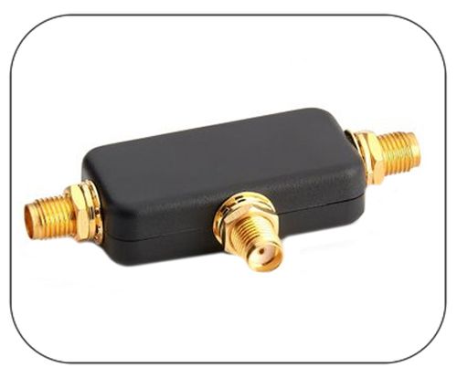

🤣🤣Is that a balon for the Airspy Youloop?? That's an amazing idea! I have
It is. I had a bad one and like always, instead of throwing it away, it went into "storage". Glad I saved it!

You need a 1/4" x 36 threads per inch (1/4x36) nut. Probably easier to just buy a new cheap SMA connector off Amazon than trying to find a single nut.
And the style with the slots for tightening as opposed to a hexagonal nut as I doubt you will have enough room to get a nut wrench or even needle nose pliers in their to tighten it.
