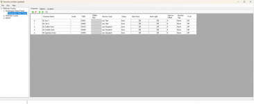

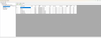

Washington State Police are on the Justice Integrated Wireless Network JIWN system. Which is a P25 Phase II system. Colfax appears to use only Phase I.
1 (1)057 (39)Steptoe ButteWhitman, WA169.4125c
59410e812DWSP D4 ColfxD4 Colfax Area
Sorry, I just got my SDS 200 and I'm trying to program it right now with Sentinel. How would I program that in... lol I attached a picture to see if I'm doing it right. I have no idea if I have to add the control freq or not.1756381414907.png

When I am in WA state I monitor WA SP via 3 methods. One is the JIWN. There is also the SP trunked system as well as old school conventional frequencies (programmed to allow for analog or P25). Perhaps all the traffic for D4 is in one place, but I find things are always too dynamic to count on it.

Not sure how they communicate, but here in Texas the State Police usually use the local agencies frequencies when they want to talk to locals.
Here is a Favorite List file I did for you for Whitman County. Includes what I saw in your list, and DOT, Amateur repeaters, and weather. Unzip and import the Whitman.hpe file using Sentinel. Quick Keys set to FL1, and departments 1-4, Weather is 99.
You have turned on all the Service Types on the scanner I would assume.
The WA state IWN sites have never been Phase 2. IWN has been undergoing maintenance for the past month. Sites are likely being upgraded and or are going through maintenance checks. Some are offline. There has been very limited WSP activity on IWN for the last 30 days.
This has been discussed in the WA forum.
D4 WSP is still using their VHF conventional frequencies.

OK, added the State Police VHF channels to the Favorite List, so use this version of the download.
