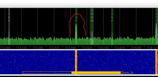

SDR Trunk and Unitrunker seem to have stopped receiving the LCRA Boerne site. I have attached a screen shot of the SDR trunk waterfall. It looks like just bursts on the frequencies?? Everything was working fine up until a couple of days ago and now neither SDR or Unitrunker are receiving the site. I have moved the antenna around inside the house and nothing changes. I have an SDS100, 436 and 536 that are all working just fine on their stock antenna's inside the house. From my location I can only receive the Boerne site so I cannot check other sites without loading up the laptop and driving to a different part of town.
Any suggestions on what to check?? I just installed SDR and got it running earlier in the week and I have been running Unitrunker for some time with no issues.
Have you looked for a new control control channel, maybe one of the SCC?

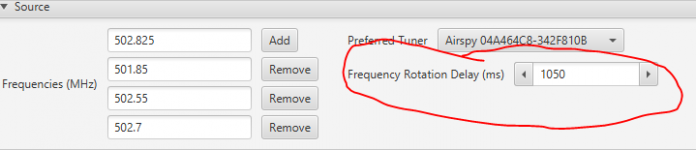

What CC is the SDS100 showing since you said it can receive the system fine? Is said CC programmed in SDRTrunk? Post a screenshot of your Tuner tab so we can see Gain & other related settings
Bursts are usually dmr.
In addition to what @Whiskey3JMC asked, post a screenshot of your programming also.

The SDS100 is showing 769.71875, I have attached some screen shots of SDR Trunk window's. I'm starting to wonder if something in my laptop has changed?? Obviously it's not a system issue as the scanner's are working and since it seems to be affecting two different programs. The antenna is a dipole sitting on top of a desk. I also took the laptop outside and nothing changed on the waterfall.

None of your screen shots show its actually receiving a decent signal. None of them are showing the markers either.
Have you checked all antenna connections and wires? Looks like reception issue. Have you tried with just 1 dongle to see if you can lock onto the control channel?
What is your rotation delay set at? If 400, bump it up.

His 4th ss in post 5 shows he has all 5 freqs programmed but does not show the rotation delay. Does not look as he is getting a great signal so bumping the delay up could help him lock onto a cc.
