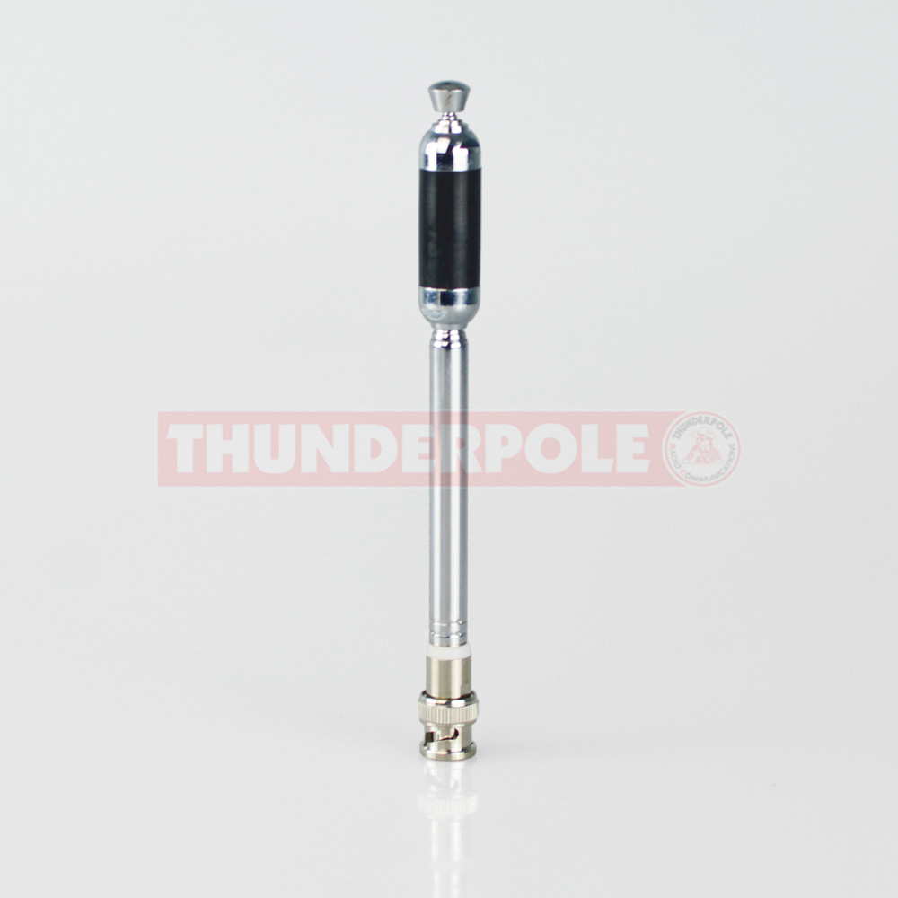

Here is some base loaded telescoping antennas designed for CB handhelds
Amazon.com
This one appears to be base and center loaded. A very compromise 5/8ths wavelength.
I would say the telescoping variants will tune up. The fixed one is a case of "cross your fingers and hope SWR is no more than a 1:5 match".
Personally, I would choose one of the telescoping variants.
