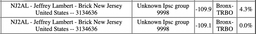

1. The callsign and name displayed for my radio ID was completely different from my name and callsign.
2. My talkgroup was displayed as "Unknown Ipsc group 9998".
3. The repeater is in fact picking up my transmission, but I am not able to hear it repeated back to me.

I have also included a screenshot of the netwatch error below.

Per the matrix, parrot is on 1. Two is for members.
Also, to OP: have you tried a regular QSO on a voice TG? And, try making it not ipsc.
Got it, will the ID update with my callsign automatically?
It pulls from a database usually entered by admin of repeater. That callsign doesnt even have an ID. Someone got entries messed up. I have not pulled a database from there in years, so no way for me to see if you show up.

All that sent on dmr is your ID number
If people have the database loaded Into their radio your call sign will show up.
If people are like me and only load dmr id's of know people they talk with on regular basis and your ID isn't stored in receiving radio all that will show on the other radio is your. 7 ID number.
Some radios use a talker alias which shows names with being out being programed in radios. This feature only works on some repeaters and should be turned off with causing more issues than it solves.
With dmr your 7 digit dmr ID isn't a legal ham ID and you still must voice your call sign at regular intervals
Oh ok, I was wondering why the call sign was different, they likely haven’t updated their ID database recently.
I’m not sure if the repeater has talker aliases enabled, but I have heard it can cause these issues.
