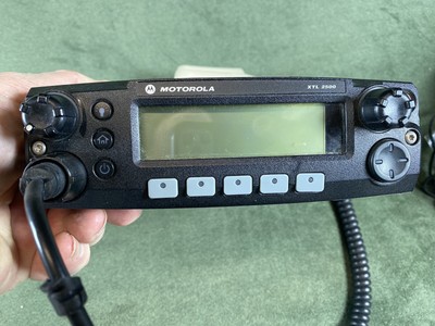

When rebanding happened, the current radios of the day could not be “upgraded” to follow the new band plan. So Moto exchanged out the old radios for new ones, but didn’t want to put users in a better place. So even though the newer radios could do 700, & digital, they made special “cheap” RB models that could work on the proper reband system, but we’re still analog, & 800 only. The tag has the RB mark to identify it. Also the specific W2BN on the model #,
like this one.
