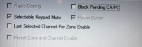

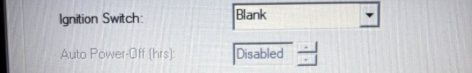

I have a XTL5000 W3 that works great but it has a switch on the db25 connector that acts like ignition sense. The on/off switch is wired to constant 12v and pin 16. Is there an alternative way to jump the connectors to enable the power button on the W3 head? In its current state, the power button within CPS is grayed out and the ignition switch field under Advanced tab doesn’t change anything. Not end of the world but would kinda like to use the actual power button on the control head. Thanks
