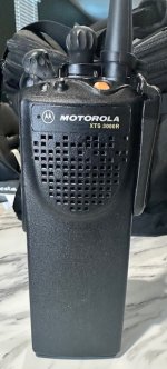

XTS3000R “modified for 20mW-2W”
mbnv992
Apr 13, 2009
703
AZ
There’s some looks like brand new old stock XTS3000R model 1 UHF radios for sale on “that site” that has “H553AJBY - Modified for 20mW-2W”. Never seen this before on any OEM tag of an XTS3000 or 5000 radio. Tags definitely look like OEM. Anyone have any info on these ? I know of the FPP XTS2500 radios that had no working LED for the PTT, had max power out of like half a watt and were for the military but never seen these before.
mbnv992
Apr 13, 2009
703
AZ
I bought one for craps and giggles. Never seen one of these before and seem to be rare. I’ll hook it up to the CPS and see what Firmware and DSP it has. Kinda curious. If it has decent power out ( 2Watts ) I’ll program it up as a spare GMRS rig. He has I think 5 total up for sale if someone else wants to add one to their collection.

I asked the seller where he got these from and he said they were test radios that were used for demonstrations from a dealer years ago. So sounds to me like these were maybe demo units ?
