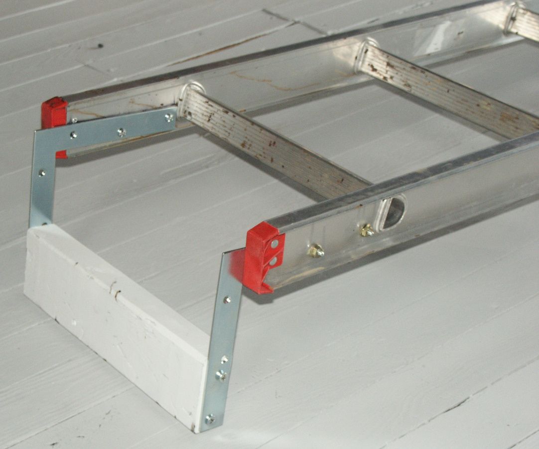

I wanted a faster way to access my roof antennas without getting my 32' fiberglass & my 16' aluminum roof ladders out. I had to have the south side of my roof replaced (tear off), so what better time to do this?
Living is one of those single story new homes built in the 50's (and later) is surely no problem as one can almost jump up on the roof without a ladder. But, being 25 or so feet up (at the peak) is another story.
There are plenty of 'roof windows' and skylights available, but none made here that actually open all the way. I was only able to find those industrial 'roof hatches' which are big, square, bulky & expensive that are designed for flat roofs.
I then found these 'roof access windows' from Fakro from Poland (believe it or not) that had a US importer out of Illinois. These are very popular in Europe due to building design and fire regulations for 2nd & 3rd floor living (though the regulations have changed), but not here unfortunately.
The US site is here;
Attic ladders, skylights and roof windows from FAKRO, What distinguishes us, offer, egress window
I choose the smallest window. It fit between the rafters, so no rafter cutting was necessary. I had it placed as high up as possible. I have a 8' fiberglass folding ladder in the attic, so that aspect was covered. What I needed was a short ladder from the window to the peak. I can climb out and get to the peak without, but that isn't the safest idea.
I looked around for a 16' aluminum extension ladder since I already did the same thing with a 32'. Splitting the two half's, using one for the "roof ladder" with a "chicken hook" (I believe that is what it is called) to hook around the opposite slope of the roof for access from the gutter.
I did the same for this 16 footer, but bought two pair of 8" 'L' brackets with a 2x4 placed between them for the 'hook'. One of those 'chicken hooks' is too large and heavy for such a short ladder.
It works out fine. I had enough room between the frame of the window and the closest leg of the tripod (I didn't want to move it) and the 8' length was just about right. I can lift it up and out, then return the ladder back inside the attic in a minute.
Pictures below:

There is a side benefit from all of this; I now have a easy view of the antennas & mast without going outside on the front porch that I use to do to confirm the TV antenna direction.
Here is the ladder mod detail. I originally used a single pair of those brackets, but found excessive side play so I doubled them up.

This worked out far better than I thought it would. I had concerned about what to do for 'steps' from the bottom of the window frame to the peak. Standing on that 8' stepladder, I can almost touch the peak. Dragging out that 32 footer, then the 16' 'roof' ladder with the 'hook' was no picnic. This is.
I go up at least once a year for maintenance. Besides, the view is great.
BTW, the window was $660 delivered.

You might look into putting a toe board near where the bottom of the ladder would sit that way your ladder won't slide down the roof while you're on it. Just a thought.

I didn't want any obstructions left on the roof. I feel this is safe and sturdy.
I added photos for the ladder mod above.
